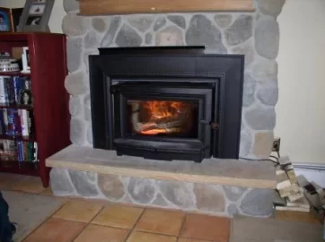

I haven't burnt a drop of oil in 2 days. I still have a lot to learn. But so far; so good.

I've been interested in knowing how well that model burns.
How big is your house?
X2
Also nice stove, looks good !
This is my 1st insert. Just installed this past Sat. 1700 sq/ft ranch with cathedral ceilings. Open floor plan living room, dining room, kicthen, and entry. three bedrooms and two baths down small hallway. Our temps. since Sat. have been mild but so far the unit is heating the entire house. I'm suprised that it does not blow me out of the room it's in. The blower works well and is not too noisy unless it's turned up high. My wife didn't want me to burn over night. I put a couple of splits on at 9pm. The furnice never came on and I was able to light kindling off the coals at 6am. I'm going to load up the box tonight to see how long the wood will last, so far it seems to burn pretty quickly. While I was at work today' my wife (no wood burning experiance) and my 14 year old son had no trouble keeping it running all day. Once it gets cold and I learn how to operate better I'll post an update. Ken
looks great what kind of flat stone is your hearth.
Welcome Ken,
Nice to see another Clydesdale owner around these parts. That's one beeeeutiful insert you have there.. Yes my opinion is a bit biased. Real nice looking install and hearth.. That insert looks great on a raised hearth. I have a ranch style as well but no raised ceilings. You might want to think about a ceiling fan to move the heat from above. If you have a somewhat open floor plane as I do you will have no problem heating your space. That's been my experience anyway..

Looks really great and glad you are getting some good performance out of it! The hearth is beautiful as well. Congrats!

Beautiful hearth! I bet you can't wait for a cold snap so you can let her run!
I'm checking the weather every hour. My 10 year old daughter said it was to hot to sleep. Any excuse to stay up late.
Ken !! Nice job !!!
You are definatley going to need an ash can, etc. I don't know what town you are in, but here are many local shops for assistance. Plow & Hearth is a good source, too. I know other members use other sites, Norhtline, Harbor & Freight, etc.
Ken, nice install there ex neighbor. I lived in Patchogue (the still decent part) for a good long time. You got yourself a great fireplace insert. I've sold tons of Clydesdales up here in the north country and always end up with a happy customer. Enjoy your stove, the long burn times and the nice soft heat.
