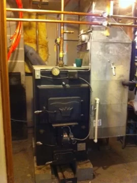

This is the link to the royall website. Not sure this is the same furnace as you have (Royal). Checkout my pic to see. Very heavy duty non gasser boilers. I have the 6150 and it holds about 30 gallons of water. Your pipe HX etc will hold a little more unless you also have storage.
