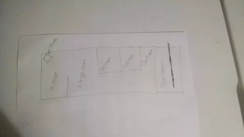

Welcome. 6" vent is good. Can you locate it centrally in the 70 ft length? Middle 2/3 of MH will probably be nice and warm - 1/6 at each end may be chilly. Pics of floor plan will help.
Thanks the Englander 13-nc looks better. Nice that I can get it from home depot. I only need to heat the main part of my house 800 sq ft. I can heat my bedroom with my electric heater. I want to put the stove on the front wall of my home in my kitchen. Corner installation.
Rough floor plan

The stove will need at least 15 ft of flue. That is going to be hard with the stove tucked into the far corner. Inboard on the living room/bedroom wall would get more height. Otherwise it's going to need a well-braced tall pipe outside.
