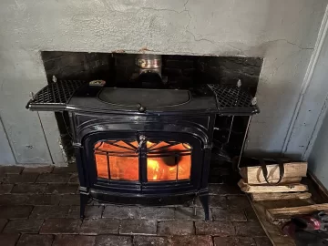

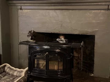

I rebuilt my early 2000s Vermont Castings Encore stove last fall and it burns much better. However, it’s getting up there in age and I’m getting to the point where it’s time to make a call. We live in a 300+ year old house that has 4 fireplaces and one wood stove — needless to say we burn a significant about of wood to offset the cost of natural gas heat.
I buy my wood either by the grapple load or in large rounds and split a season ahead. I like the work and it saves me alot of money by using my log splitter and buying green wood. A “cord” and that’s a loose term based on what I’ve seen people try to sell me; goes for anywhere between $375 and $500 with delivery usually an extra $25-$75. No thanks.
I built a woodshed last year which can hold about 5 cords. Now, it’s alot of work to split that much wood and I’m wondering if a newer stove would be worth the investment rather than burning more wood with a less efficient, older stove like mine. Also, I’ve read some older threads on here about the Vermont Castings stoves and they aren’t great.

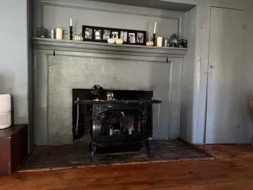

Our house was built in 1715 and has a huge central chimney like most first period homes — I’m wondering if there are better stoves that would heat more efficiently and not look too out of place. The one thing I like about the Vermont Castings is that it fits in with the style of the home.

Welcome to the forum. You just rebuilt the stove i.e. put $$ into it. I would run it until it needs major work again. With horizontal pipe outlet you are limited to very few stove manufacturers.

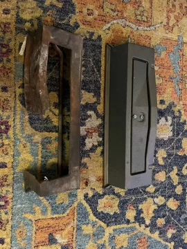

Once I reviewed the manual, I was able to look at the parts online and determine what I would likely need to invest in the rebuild. Luckily, the only real expensive part was the damper chamber — from the pic attached you can see that it was in rough shape.
Parts I bought:
1. Damper chamber (full assembly)
2. Gasket kit (replaced all the dried out gaskets)
3. (1) firebrick to shore up some holes in the back of the stove near the pipe assembly
4. New glass mounting brackets (I had to drill out the old screws because they were welded into the cast iron — tapped new threads and replaced screws with hex head stainless steel)
5. Replaced a majority of the old screws and bolts and upgraded to stainless steel (a little more expensive but I splurged)
6. Replaced the damper handle with an OEM Vermont Castings wood handle
7. Replaced the griddle handle
8. Replaced the thermostat handle
9. Replaced one of the warming rack arm supports as the original one snapped off
Overall, it wasn’t a bad project. It took me about three weeks of working on it on/off. I also had to wait for parts to arrive but the vendor I found was really fast. The fountain assembly and shoe are still fairly solid, but those will likely need to be replaced down the road. We Typically burn 3-4 cords a season.

There are some choices for rear-vent stoves from Woodstock, etc. if it comes down to having to make a change but it looks like the main factor is the fireplace lintel height. The Encore looks like it is vertical venting, not horizontal. If so, there are several choices that might work depending on that height.

@WickedOldSaltbox1715 Did you disassemble the stove completely? Didn't realize your stove was enameled, mine isn't. What happened to your damper chamber? I've had mine 35 years and the damper section is fine.

A newer stove wont be very much more efficient if any at all. It takes "X" amount of BTU to heat your home, swapping from one CAT stove to a newer CAT stove wont create BTU output, but if the newer stove is larger you can fit more wood in it to burn longer. And pretty much every other brand new stove out there is easier to run than the VC Encore.
