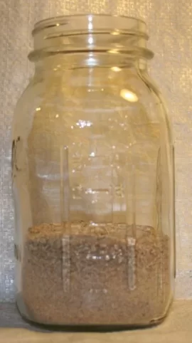

Clean Energy results
Temp average 249ºF
Ash volume 18 ounces
Ash 8.64 weight onces
Ash Percentage .653%
Density 42.37 LBS.
Fines volume 8 ounces
Fines 3.21 ounces
Fines Percentage .242%
Bag Weight Bag 1 41.36 LBS
Bag 2 41.43 LBS
Diameter .267
Length 1/4 to 1 5/16
Total Burn Length: 24 hrs 05 min
  • [Hearth.com] (-: 2010 Pellet review its that time again! :-)
Reactions: SmokeyTheBear
