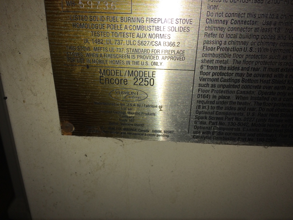

Hi all- I bought a house in this past spring that has a VC Encore 2250. I have no experience with VC stoves. The issue is that the damper won't close. I opened it up by taking off the flue collar & the damper bar doesn't really connect to the damper. It catches it for about 1/2in & then the damper just falls back. Is this bar warped possibly? I assume the previous owner over-burned this stove pretty often because a lot of the paint is peeling on the left side. Not sure whether or not to rebuild it or just look into getting a new stove. I'd like to hear thoughts. If all i have to do is fix the damper, i can probably do that on my own. But I have a feeling this thing will end up needing a full re-build. Nothing on the inside of the firebox appears to be warped. So far I bought a gasket kit to replace those, but that's it. Would like to get the damper situation squared away before winter in VT really gears up...
Most likely it is the upper fireback that is warped.
Take some pictures from looking into the stove angle.
We will be able to tell more then.
ok will do thanks. Am i correct to assume that VC Fireback kit #5927 works for the VC 2250? I know that kit is for the 2550, but i haven't been able to find anything for the 2250. I know the stoves are pretty close to the same
Are you sure it is a 2250 not 2550?
It's definitely an Encore 2250. I can't really find anything at all on this model
I could be wrong, but I have never heard of this Encore 2250 model.
Picture of the back plate??
Loads, can you take a photo of the information plate on the back of the stove? Ive never heard of the 2250 either.

Ok snapped a few pics. Back plate & then some of the inside

This is just too bizarre.
I stand corrected!
The insides look ok to me.
What is interesting is the bilingual plate. This could have been a limited number of units produced for the Quebec consumer group. I have gone through four Encores and none of them had French on the back plates. And I am in Canada (the country of English ((eh)) and the other "funny" tounge.......spoken).....
