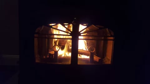

Im like a kid in a candy store.. i couldnt wait to burn. Friday night i opened up the windows saturday morning it was 62 in the house.. lite the stove for the first fire of the season.. i ran it long enough to birn the stink off it and make sure all was good. This morningi lite the stove again. Only for an hour and a half and let it go out. The temps are favorable for having a fire here and tjere this week 20181013_060618.jpg
