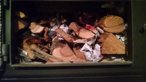

Looks like i have a mini chimney fire. today was warm outside but the temp in the house when i got here was low 50s with 72 outside. i run the pellets stoves to bring the house to temp and got clean the BK and fill it up with a mix of big splits and kindlings on top for a top down fire. Ones got dark and outside temp start to drop I fired up.it was full. lol. I had newspaper and a piece of super cedar in there.
Everything was going ok and nice quick fire when i noticed the flue temp rising to quick. I keep my eyes on it and it climbs to 900 df in no time. HELL NO. I closed the bypass (it was almost in the active zone at that time) and closed the tstat. I was able to noticed something going on around the flue collar and about a couple feet up the flue. For sure was flame activity there.
About two minutes after I closed bypass and tstat, the flue probe stopped climbing and things got quiet in the flue. I open the tstat wide open and burn on high like always and the flue temp start to go down and everything comeback to normal.
I went outside during that time and nothing looks abnormal, no sign of chimney fire at all but i was able to hear the sound of fire in the lowest part of the flue pipe close to the collar. Is there something i should worry about?
Any input/help will be appreciate it.
When you say you cleaned the stove, do you mean you cleaned out the ashes? Or cleaned the flue?
I really got hell going on in there::-)

Well, I can say everything is normal like always. it was just those few minutes that scared the crap out of me. This is almost three hours into the burn.
What's the purpose of the wadded newspaper distributed throughout the load? Won't the fire spread quickly if you start it localized to one spot? I've never seen this technique used. My experience is that newspaper ash slows everything down.
Reactions: Marshy
I don't know how is supposed to work, but look the time of the pictures and you will see is less than five minutes window and that thing was going nuclear. It was loaded in the tight side.and I put some newspapers around. Hey, if it works, it works. Taking pictures was when I noticed something weird!!!. The cat was almost touching between inactive/active line. Lol. That was quick:)
I load the box full and place a small piece of Super Cedar in the middle of it. The fire spreads very rapidly. I never use any paper, it's just not necessary with a good fire starter.
Your flue temp of 900 internal is not a problem. that's in the normal range. Mine was at 900 just last night during the 30 minute warm up after cat engagement. That doesn't mean you didn't have a chimney fire though.
The good news is that there are small chimney fires and there are big ones. I believe that small ones are common and unnoticed by many. Some folks still ignite them intentionally to prevent big chimney fires.
Yeah, normally i can see 900 flue temp if burning on high for those 20-30 minutes recommended after reloads or cold starts, but it gets there in a slow way. This time it got there in seconds and i can hear/feel something roaring in the flue, plus it got hot. The house was getting heat up just with the flue temperature;lol.
