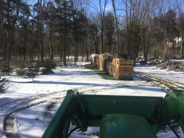

Had to do this with a cord...lol...I really feel your pain!I finally proved out one criteria in which my old Jotuls were better than my new BKs. The Jotuls took 20-22" splits, where as the BKs take 16-18". Whereas I've been thru maybe 50 cords if Jotul wood, without ever having a stack topple, I've had two BK stacks topple in the last month! Maybe I need to start using more yard space, and stop stacking as high.
Maybe BK needs to size their stoves to take proper full-sized splits, not this miniature wood! [emoji14]. I won't even go into the time spent cutting 4" off every stick of the 30 cords I had CSSd, when I bought them!
