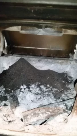

i'm glad i went up there. Since it was nice out, I cleaned the chimney.... The cap was pretty disgusting, so I cleaned it out with a brush, shook it around and got it nice and clean. This is what came out of it.
[Hearth.com] 2016/2017 VC owners thread
I took a look down the chimney, and this is what I found.
I swept it out, and got it to look like this
I ended up with this much stuff that came down.
I also cleaned out everything in the stove, took out the catalyst. it turns out I get to make a call to VC today, since my 1 year old catalyst has some broken parts....
[Hearth.com] 2016/2017 VC owners thread [Hearth.com] 2016/2017 VC owners thread
It turns out I didn't get down far enough (i missed about a foot from the bottom of the stack).
I will be burning hotter for sure, I think I have been cutting off the air a little too soon. I also got a cheapo magnetic thermometer for the stove pipe, and after fidgeting with it for an hour or so, i was able to get it to be pretty comparable to the infared thermometer

Your second pic is a bit alarming to me. Either your wood is subpar or your burning too low.
Dobish,
everything i've measured has been under 18%, so my guess is I am burning too low. I have been burning a lot of elm with the bark on, so that may be adding to it. I plan on burning hotter for sure though. last couple of nights I have actually been able to see the flames above the catalyst.
