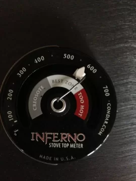

My new 2040 that previously would maintain a 400 deg stove top temp for hours will no longer perform that. A full load burns off in 6 hours with stove top temp of 550-625 with air control on low. I have done a smoke stick can't find a source of uncontrolled air. I think it started doing this last week when I got busy for a few minutes and closed damper at 650 deg stove top and put it on low to bring it down. Hasn't been the same since. I don't see any signs of warping.
Any tips or tricks? I need my old stove back I don't trust it anymore.
This is pretty average for this stove.
Gaskets maybe. Or an obstruction with the primary air inlet. Do you have any control?
Reactions: BronYrAur
You see 600' midway through burn cycle on low?
600 might be a bit high, but 500-550 yup. The magnetic thermo might be off too....
But if you have no control over the stove. That is, set fully closed and you see lots of flame in the box, then a leaking gasket somewhere for sure!

Thanks for the help guys.
I have moderate to good flame control but coals tend to glow brighter than before... don't get to tell the stove top temp what to do like I was able previously, I marveled at the control I had before.
Checked the primary air function it is behaving and closing completely
I smoke penned the front doors and ash pan, no draw but I'll adjust them tighter. After I had closed the damper that time it got hot there was a louder pop/click than the stove usually makes from time to time which led me to believe I had cracked something or popped a piece of stove cement out. I peeked around the inside the stove the best I could didn't see anything out of place although I am new to this stove.

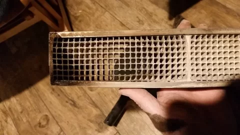

I had a really good burn last night in my defiant. Cat peaked at about 1625. Cruised real well. Then this morning on my reload the cat raced up to 1100 then dropped to 875 then climbed back up to 1050 then dropped to 775 then went back up and dropped again. Finally after watching it do this for awhile it settled in at 1300. Wired. Don't know what to make of it.
I will get that kind of behavior sometimes on windy days. Also, when was the last time you removed the hood and looked at the cat?
Anytime my stove is cold (not very often lately), I will take a peak at the cat. Take a small brush with soft bristles and gently run it across the top of the cat. There is always a bit of ash on top of the cat.
I am currently letting the stove go cold so I can give the cat a cleaning.

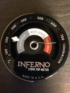

I have a marker on my thermostat, the marker does read 30-40 deg high.
All gaskets are good. Thermostat assembly operates correctly. This was on low and towards the later half of the burn cycle. Also the cat is operating much warmer and there's an audible rumble, I don't have the AT100 probe but do have factory probe its reading upper 1/3 to 1/4 during burn cycle.
