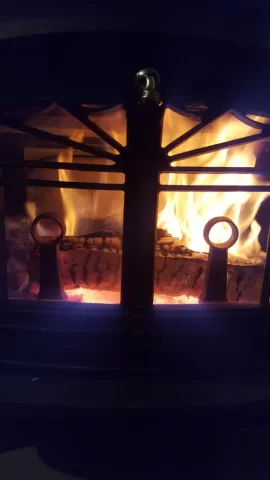

My glass is dirty after every overnight burn. Each morning i drop in some wood and get it up to 600 to 650 and it all burns off.. clean as a whistle after 40 minutes. This is what my glass looks like with no cleaning

My glass is dirty after every overnight burn. Each morning i drop in some wood and get it up to 600 to 650 and it all burns off.. clean as a whistle after 40 minutes. This is what my glass looks like with no cleaningView attachment 235788
Hum, my glass has never cleaned up like that. But I rarely run the stove at anything above 550 GT. Maybe I'm running it just too cold for it to burn off? Kevin
Run it like 600 or so for a little.. it will clean up. When i clean out my stove i also take a damp paper towel and wipe down the glass from all the fly ash that sticks to the glass. Sometimes there is some black on the glass and that just wipes off also..
Woodsplitter, got what your saying. The stove is in a small addition to the house so running it at 600 or more for any extended length of time would over heat the room. Around 500 is where I'm usually at. Can see from your picture its cranking pretty good. Kevin
My stove is in an open flooor plan.. it makes a big difference.. i see your dilemma..

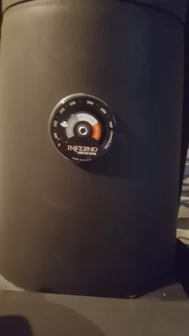

Pulled coals to the front, packed my stove with wood, stove went to 400 so I closed the damper and then the air to get a low long burn.
I ended up with GT or 300 and a cat temp of 1380 degrees. I could hear the rushing sound.
I have 8” Ventis Class a double wall pipe so I have no idea what the flue temp is at any time. If my cat temp is 1400 what would my flue temp be, and should I woory?
How hot is too hot for the cat?
Right now i’vevsett It down to 625 on the gt, and 925 on the cat. I don’t need 650, 450 would be great.

That rushing sound or baby jet engine sound is your cat running and that sound is good. 1300 is a good number. I also have 8in pipe. I mesure right before it gets to the 8in double wall. This would be the collar that connects the stove and the double wall pipe Not a super optimal spot but close enough. I also take my IR gun and read where it is vented.. where i can see the inside wall pipe. I just started the stove so the temp is a little low
