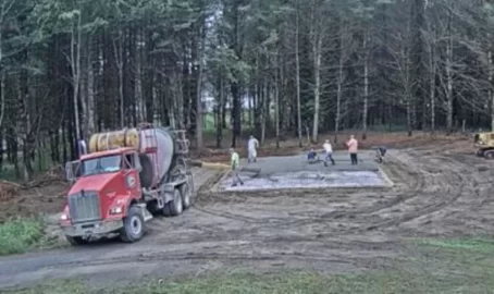

The pouring of the garage floor or slab went good this morning, it took less than an hour to finish the pour. The first truck was able to do the pour from the east & west sides of the garage, the second truck finished the pour from the front.
After they finished pouring the sun came out and we had some winds all day, the owner finished off the pad earlier and is gone for the day.
Everything except for the metal roof was delivered so they can get going on finishing the garage. :)
