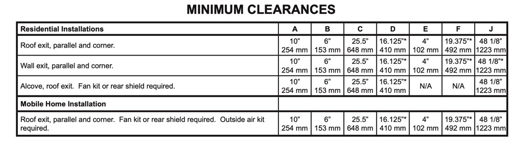

You do have the side shields. Fans at the back?I was amazed with the 4” from corner to wall requirement. That’s crazy close. I went 6” just to give it a little more room. The wall gets pretty warm, a little hot even. I can keep my hand on it but it’s hot. I guess this is ok?
I am not an expert. Calling @bholler .The manual showed no rear shield required for my install. Residential, roof exit, corner it says 4” minimum (measurement E). Had a certified NFI installer confirm when he helped me set it. Did I miss something? I could always move it out but he said I was good.
125 should be okI took a temp measurement with my infrared thermometer. The stove is around 550-600 right now and the wall is just 125. I mean don’t natural gas vents blow out hotter than that? Seems okay to me but I’ll let the experts weigh in. Appreciate it!!
How’s your ceiling clearance? I see the door tops so I know you’re close. Need something like 50”.The manual showed no rear shield required for my install. Residential, roof exit, corner it says 4” minimum (measurement E). Had a certified NFI installer confirm when he helped me set it. Did I miss something? I could always move it out but he said I was good.
Good, I accidentally left zero margin on that one!Yeah that’s J. I have like 54”.
