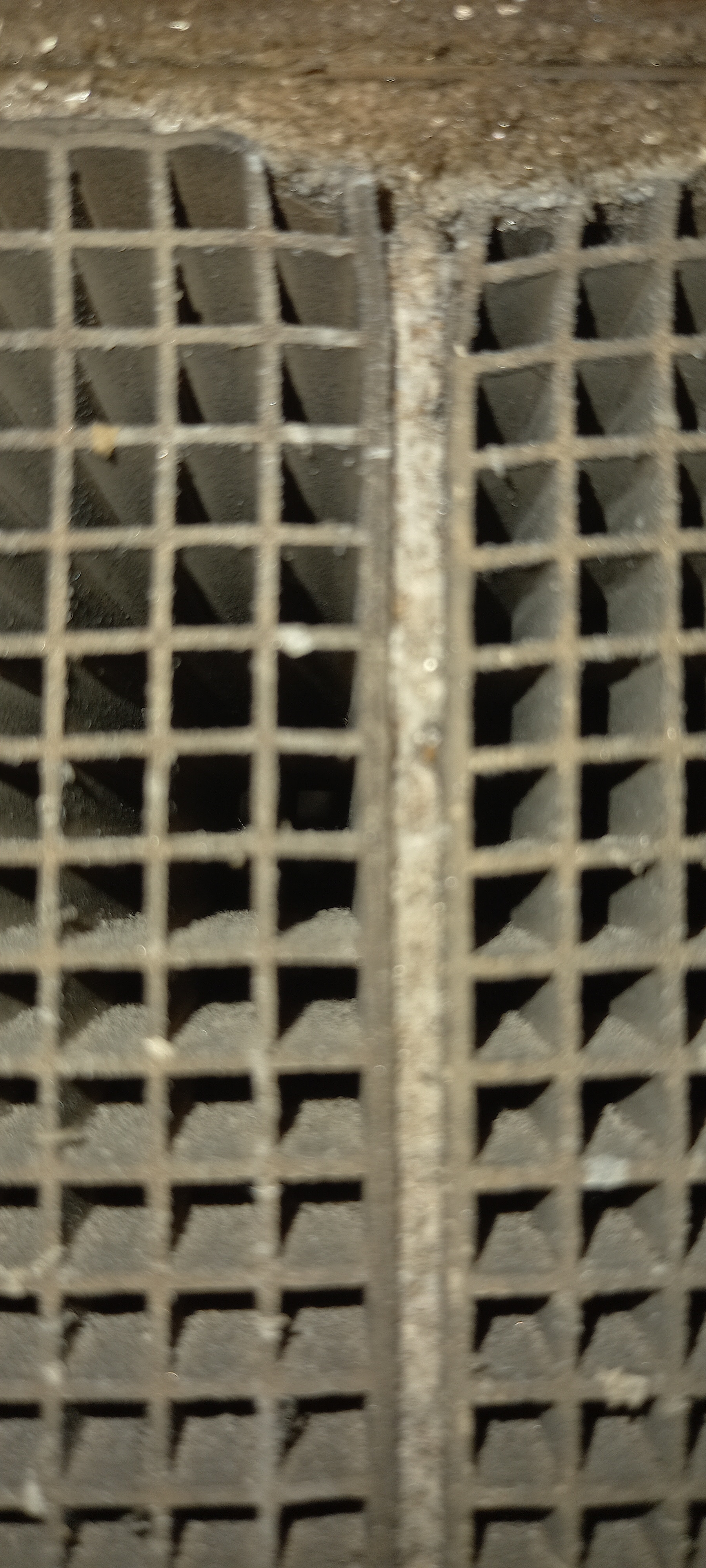

I Let the stove burn out today while I was at work and cleaned out the ashes. Then I was going to vacuum the fly ash off the cat when I noticed some of the center cells have some minor deformation.
What do you guys think?

and a close up on the worst spot.

I've been running it low and the cat needle is often passed max when cooking reloads but settles into 3/4 range after a hour or so.
Im thinking it's from manufacturer but Ive never looked at the cat before operating the stove so I have nothing to compare it to.

Couldn't this be deformation because of whatever is covering the top middle? That inhibits flow, and thus it's cooler in that area. That creates strain. And possibly deformation (though is this a ceramic substrate cat? I'm surprised they deform rather than crack...)
Regardless, the rest will work fine if the active surface coating is still present.
If this is creosote coating the top part, then something is not going exactly as it should - I'd engage the cat a bit later (hotter).
Looks like a piece of gasket to me..

I dont think the cat is damaged or needs replacing just curious about the bending of the cells right at the joint of both catalysts.
Oh ya I'm still running it.

Does a anybody know what type of mortar or sealant is used to glue the 2 pieces of cat together?
No mortar, just gaskets and banded..
