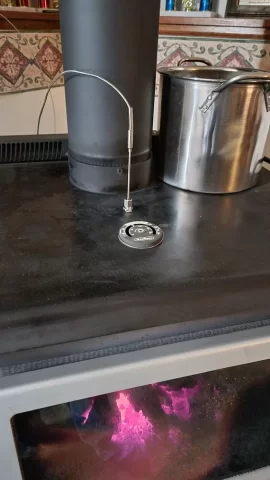

I finally got a solid thermocouple setup for my Princess. Using a K type thermocouple hooked to a PID controller that my dad got me from his work. The thermocouple has a working temp of up to 2000* and is used for aviation EGTs and has a sealed tip. I was easily able to start a 1/8npt tap in the factory cat temp hole to thread it. I ordered the thermocouple with a 1/8npt compression fitting to set its depth.
From what I've seen, the analog thermometers (stock and the numbered condor) are pretty inflated. While charring a fresh load the TC sees 1100-1300* and when turned down and letting the Stat do its thing, it's usually between 750-1150*. 12 hours into a burn when everything is black dried out charcoal, it hangs between 550-750* depending on the Stat. This is with a fairly fresh ceramic cat from midwest (75-100 hours on it).
Overall, it satisfies my OCD to see digital #s from across the room rather than a lagging analog thermometer.
