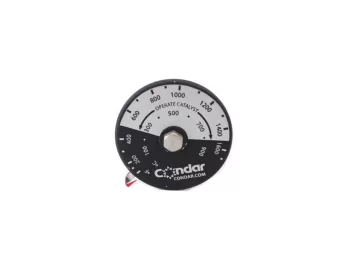

my current catalyst probe has the majority of the writing smudged off, it probably doesn’t need to be replaced but I would like to replace it. Is their an off brand that would work the same. I see Amazon has a few for around $30. Thoughts or suggestions.
