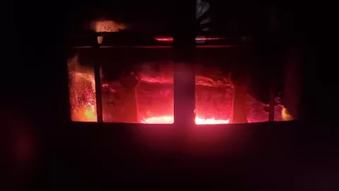

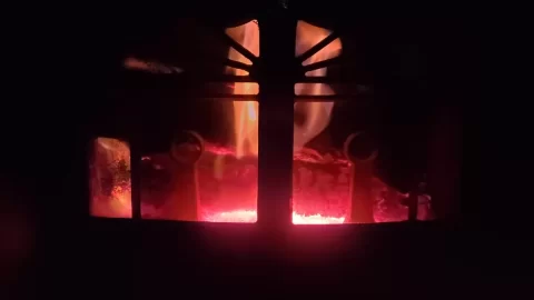

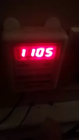

this mornings burn..
Reactions: Pressroll
