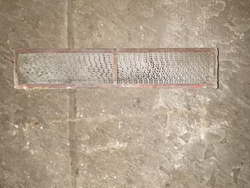

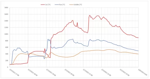

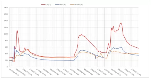

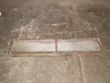

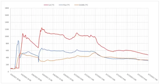

Happy Monday all....

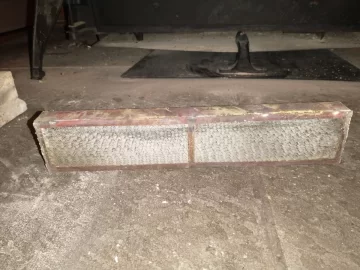

Seeing some very odd stove behavior the last 2 burns. Seems to be taking much longer to get my cat up to temp and then once it does light off when I close down the air it crashes the cat. Very strange.....
Sunday morning I woke to find the stove pretty cold and a lot of unburned coals, I opened the air up at 4:30 and the cat went to 1000. The overnight air setting was ~40% so it was not like I had it choked down.
On the next load at 9:20 cat temps went up as normal and then crashed, I actually plugged the secondary inlet around 9:50 to get the cat to light off. Once it did it seemed fine for a few hours.
I opened up the refractory last night and inspected.... all seemed normal. Pics of the metal cat are below, it looks to be in pretty good shape. The frame is still relatively square and straight. The mesh is clearly more distorted than it was but is still structurally sound.
1678107326121.png IMG_20230305_192348073.jpg IMG_20230305_192337671.jpg IMG_20230305_192322028.jpg
View attachment 310677 View attachment 310678
this was something that was happening to me a number of weeks ago.. did the shutter adjustment and vacuumed ot the inside of the stove...
I thought of you when it happened.....
Last nights burn was more "normal" but it still went to 1400 pretty quick, then slowly crashed to 800 and then ramped back to 1400 over the course of 3 hours....
This morning had a lot of unburned wood still in there, opened the air up and cat went from 400 to 900 before dying off.
Stove is cooling today so might have another peek tonight.

The unburnt wood is saying.. yo.. im stalling.. WTF when I was waking up at 5am is what i said back

Mine was doing this after running pretty hard for about 10 days in a row and when I cleaned out the ash it went back to normal. It was loaded. That is what prompted me to ask the primary air flow question. I was curious if having too much ash would restrict the flow and cause the cat to stall. Seems to be the answer is yes, but not for the reason I was thinking
I looked mine over real good and I do not see any issues, had a build up of some fly ash under the cat but not a ton..... I did notice a larger than normal gap between the front and rear refractory sections, I considered stuffing it with some insulation but decided to leave it for now. I could use more secondary air anyway to keep the temps down.
I do not see how it is possible to restrict airflow with ash buildup. The only passage that could get plugged are the 8 holes in the front refractory at the bottom, and they always seem to be covered by the ash anyway.....
I suppose if you had a massive pile of ash underneath the cat you could choke the draft there a bit and reduce airflow when in cat mode. Air does not flow up through the ash pan area so if that is full or not shouldn't matter. (mine was emptied 2 days ago)
🤷‍♂️ IDK..... I put some wood in it "and fired that mother up", to quote the late, great Charlie Daniels. I'll let you know in the morning.....

Perfect burn last night.... I do not know how or why. Apparently pigs are now flying and hell has in fact frozen over.....
  • Key damper was open for the entire burn
  • Stove was cold so I light off a few sticks to get some heat in the stove and the flue got fairly hot.... cat light off with no trouble.
  • Let that burn down to coals and then loaded up with a full load of red oak, large and med size splits.
  • Immediately engaged the cat, air set to 100% open.
  • Nudged the air down slowly a couple times to 50%, cat settled in around 1230.
  • Cat temps were very stable and slowly decayed overnight down to 1000 when the cat quit.
  • Woke up to a nice 4" bed of hot coals still throwing plenty of heat....
What changed to achieve this result? Nothing....
I have a hunch that I have secondary air leaking through the refractory seam into the smoke stream just above the cat and that is helping to control the cat exit temps by increasing the amount of excess air in the reaction. If this trend continues I may try plugging it just to confirm. (Keywords: If this trend continues....)🙏🤞

Do not fret....all is right with the world, pigs are grounded and hell has thawed.
Last nights burn, same procedure as previous....
  • Key damper open, small splits to start, then a full load of larger oak splits.
  • Cat lit off quick, brought the air back in increments to 50% at 1100
  • Peaked at 1400 and then came back down all on its own, no adjustments, I thought we were on a good trajectory
  • 21:10 the cat rocketed off to 1600.... I have no idea why, I was asleep.
  • Smaller but hot bed of coals when I woke up this morning.

The spike was probably due to a piece of wood falling down as the ones beneath it burned away. I see the same thing happen in my stove. Wood burning is a highly chaotic process so you're never going to repeat the same behavior exactly twice.
Or another possibility is that the moisture in the center of the split finally finished baking off.. a process that can take several hours even for <20% wood.
Sure that all makes sense and seems like a logical explanation.
What continues to irritate me though is that this is happening at >1400F for sustained periods of time.

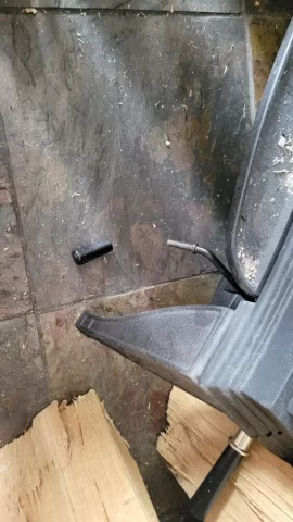

Be grateful . Our stove is 5 months old. We paid $9g and 3 things have broken on it so far. This Defiant has been a huge disappointment and i am embarassed i bought it. We bought it for the 14 hour burn aspect, we got almost 8 hours one day. We have spent hundreds of hours perfecting and honing our burning skills too. I would never buy this crap in the future.
What are your issues?

Hey there,
Just chiming in on your stall and unburnt wood.
So I had a similar issue recently. I had smoke pouring back into the room from the top griddle and would end up with unburnt wood. Gasket looked fine. It really had me paranoid that I had a monster creosote clog in the chimney that I can't inspect from the inside due to an elbow.
SO I had to finish running the stove with primary open.
There was a monster wind storm in the area. On one side of my chimney there was a small shopping bag stuck to my chimney near the cap. I eventually crawled up there and removed it, thankfully it wasnt burnt on but it was melted a bit.
I tried to burn again and has the same exact issue.
Turns out, while I normally leave coals against the secondary entrance - for whatever reason my recent burning of mostly oak only has created ash that clogs the air flow more than normal. And I probably should have cleaned this out sooner. I took out about 1/2 of a 5 gal bucket of ash/coals, and I've burned a good bit of wood since with no issue.
If you have this issue again, just make a space for near coals to build up in that area, sweeping the old to the sides and forward a bit.
The ashpan handle wouldn't open very easy and bent to the the point of breaking so had to get it replaced. Then the wooden knob fell off of it. The ashpan is warped out of shape beyond repair from the heat!!! Really? This is a wood stove. The longest burn time was 8 hours. We have applied every method and followed a lot of research advice. Oh and the first time I looked at the catalyst it was broken into pieces. (They did replace it though)
