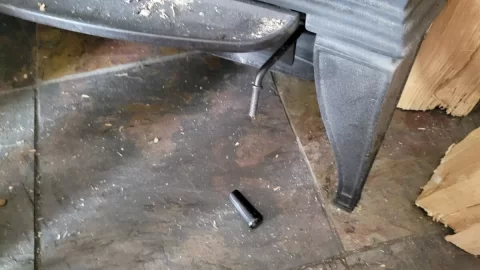

6 month old VC Defiant disappointment
wolfize69
Jan 19, 2023
22
Glendorado
The ashpan handle wouldn't turn and was very difficult to open and it bent out of shape to the point of breaking. The wooden knob fell off. The heat from the stove has already warped the pan so bad it doesn't want to open or close. The damper seems like it is going to break at any moment. We have spent hundreds of hours attempting to get more than 8 hours burn on this crappy stove and there is NO way. We bought it because the guy gave us (unfortunately) a verbal guarantee that it was a 14 hour stove but would be more like 12. I would be elated if we could even get 8 hours regularly! This was installed October 5th, 2022.

Ash pan or the drawer itself. Ash pan shouldn't be warped. Never leave that open even during a cold start. People recommending that should stop immediately. If not left open then you have a serious leak and need to call for warranty service.

Warping of the ashpan is most uncommon. This may be the first time someone has posted the concern.

Im more concerned about the warped ash pan. I would stop operating the stove until I got to the bottom of that.
The only thing that should be open, would be during a cold start - you can crack the door a little bit. No more than say 15 minutes though.

This thing is only 5 months old. The handle was only used to open it every 2-3 days to clean per the instructions.
OK, so it was not used for starting the stove. Can you detail the operating procedures followed for starting and running the stove. There are good owners of these stoves that may be able to spot an issue. I am heading out of town so I won't be able to follow this except later at night.
Of course, there's also a possibility of a factory defect like a poor or missing gasket that is at the heart of this issue. As I noted earlier, it is very untypical.
Earlier this year I found that the ring on the latch for my glass doors was frozen. The ashpan uses the same style latch so you might check and see if that ring is rotating. I freed it up with a pair of pliers and then disassembled it and polished the shaft OD and the ring ID.

The warped ash pan might just be the rack the pan sits in being a little bent, mine has done that. The handle breaking is odd as mine is old and never had any problems like that and that handle doesn't get very hot. The mechanism that latches the door might need a little adjustment.

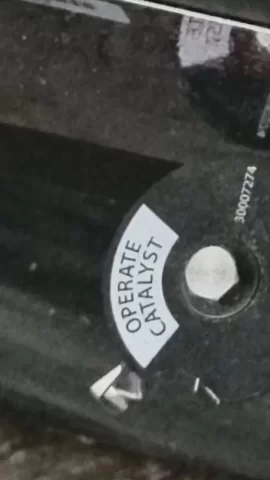

As you can see, VC went generic with their materials. My Cat probe only indicates when it is ready to be activated so you can shut the damper.
This is normal other stoves use bimetal thermometers like this.. I walked by a hearthstone today at the stove shop and they use the same thing.. You probably should upgrade to digital.. you catalyst will operate better and longer.
