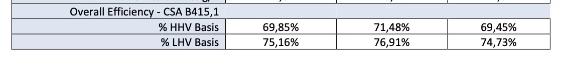

I was wondering if this refers to Enerco's (Cleveland Ironworks) line of stoves. The EPA database lists their stoves as 70% efficient, but they continue to advertise this at Home Depot and other places.

This is for the Huron from Cleveland's website.
[Hearth.com] 2023 Biomass Tax Credit Clarification
I was wondering if this refers to Enerco's (Cleveland Ironworks) line of stoves. The EPA database lists their stoves as 68-73% efficient, but they continue to advertise this at Home Depot and other places.
No idea, but there are others also using individual run performance as the metric. You can open test reports and they show very clearly the efficiency numbers for each test run.

Yes, I did that early on. They are claiming tax credit certification based on the LHV results. The HHV results averaged 70%.

You can find at least 2-3 others doing the same thing.
