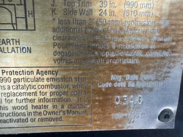

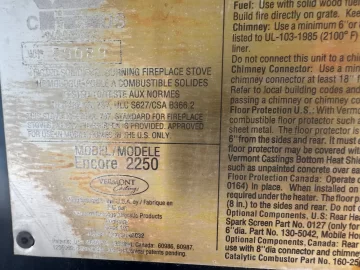

2250?! Anyone got info? I thought I was buying a 2550 :(
NYC
Jul 5, 2026
2
NY
Hi!
Like the thread says - turns out I got myself a 2250 not a 2550. It’s not in terrible shape but I need at minimum a refractory assembly and catalytic combustor.
My understanding is that it’s an early version of the 2550.
Are the parts interchangeable?
I gotta get this bad boy installed by fall!
Thanks!
  • [Hearth.com] 2250?! Anyone got info?   I thought I was buying a 2550 :(
It's an oddball variation. Vermont Castings changed hands several times between 1990 and 2013. I'm guessing this stove was made in 2006.
Parts don't show up on Woodmans. Have you checked with a VC dealer? If you have the manual for the stove can you post a picture of the parts diagram?
