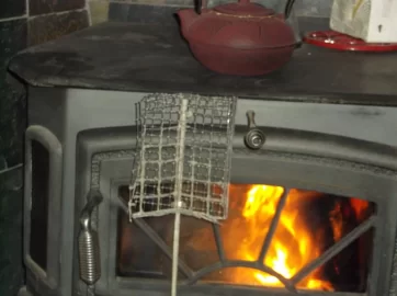

I pull every thing to one side then sift with the homemade tool shown putting the coals on the opposite side, then remove only the ash.
Then restart with hot coals and kindling or maybe a small piece of fire starter and kindling.
