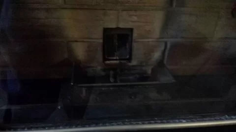

Had this done to the burn put this year. Seems to be working excellently. It's a 1" lip added at a 45 degree angle on the three sides of the burn pot.

I had a 25-epi and used to leave the logs in just to control the bounce and ash build up. Worked for me...
How did you get that done?
Had a local welding shop add some stock material to it. They charged me 40 bucks.
