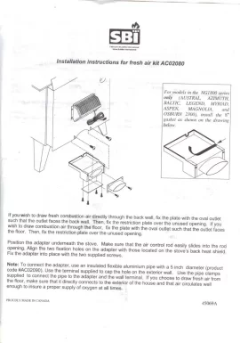

Where can I buy a 25' INSULATED 5" FLEX PIPE for an OAK at a good price.

Drolet is suggesting 5 inches. Maybe I can use 4 inches for the pipe and use a reducer???????????????
Can you point me to the source of that information? How long will your run be?
PS: Never mind I see their adapter. That is plain goofy and definitely an oddball. They resell the recommended ducting. It is just insulated warm air duct. But personally I would not be comfortable with vinyl wrapped duct so close to the back of the stove. There are better and safer ways to do this than what they recommend. Wish Fyrebug was still around, I would take it up with him.

I scan a copy of the instructions (see Below)
