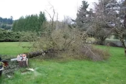

While the 211 is smaller, it is a great saw. I bought several to ship overseas and one guy wanted me to break his in so it was a 'used' saws, and thus not subject to import duty. So I dropped two birch trees with it on my property and it did a great job, was easy to use, and light and nimble. It is WAY better than the 210 that it replaces (I had one of those and never liked it), it is lighter, and it has about the same power as a 230. It is like a half size 361. I liked it so much I bought one for myself. The one drawback is the stamped steel connecting rod in these new smaller saws though.
Here is one of two 40 foot birch trees I felled with a 211, it made falling, limbing and bucking a breeze
