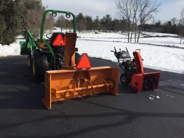

I think I will stick with my used Honda track drive with hydrostatic. I never had any real issues with friction disk machines. I did stock spare disk as that's not anything that you will find on the shelf when you need it. Definitely a PITA to change out in cold garage.
Mine's only a little 2-stage'r, but it gets the job done. ;lol
When you can throw snow 60+ feet with 2 stages, what's the point of the third?

My ca.2000 Ariens 824 (pictured above) uses a friction disc drive. It's the one point of semi-regular frustration, on that otherwise mostly reliable machine.
My old Toro (1970's) used a belt drive, which meant it only had one speed, but was as reliable as concrete.
The big Woods blower uses a hydrostatic drive, by Deere. :p
