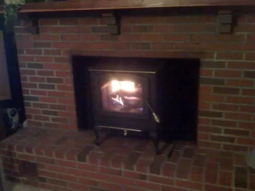

I finished up my Englander 30-NC install today. Just wanted to so say thanks to everybody who chipped in answering my questions over the past several days.
The wifey and I were able to get the 450-lb monster off of my truck, across the deck, into the house, and up into the fireplace. This was the hardest part of the job. Installing the chimney liner was pretty simple, as was the top plate.
So, again, thanks. Now we just need some actual cold weather so I can see how well the heat will circulate around the house.
Sorry about the poor quality photo.

Might want to consider putting lower block off plate in also. Keep that heat in the home.
Looks great! Almost carbon copy of BB's
Hogwildz, I did put a makeshift blockoff plate in. Just sheet metal roughly cut to shape for now, but I would guess even this is far better than nothing. Luckily more than half of the stove is outside of the fireplace so we should get good radiation into the house.

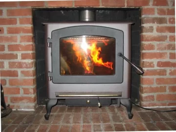

Brother Bart, after reading that your setup looks like mine I poked around for a photo but didn't find one. Care to share?

  • [Hearth.com] 30-NC install complete. Thanks!
Eeewww!!! - an ugly steel plate stove with the door handle on the wrong side! %-P Rick
Will you be adding a hearth extension to achieve 18" of hearth in front of the stove?
It will definitely be needed. For ember protection and the 30 tosses a bunch of heat down through the glass to the floor. In fact more than 18" is a good idea for the heat part.

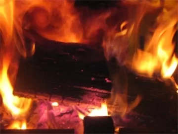

My favorite is the one of the first fire last season.
I have to admit that I love the HUGE and unobstructed viewing glass of the 30. Its pretty cool. (well in BroB's pic it would be hotter than hell)

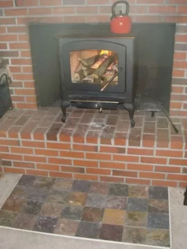

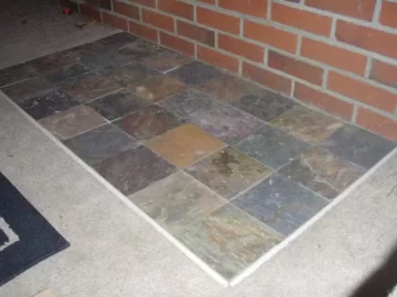

And now the hearth extension is done. Next step: the new mantel.
