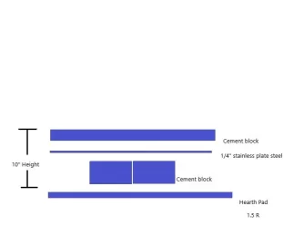

I ran into a picture that someone posted of their 30-NC and they had used cement blocks to raise it off the ground, as I am told they sit very low. is there any disadvantage to making the same setup in this picture with only ONE row of cement blocks? and then I have a couple 4x8 sheets of 1/4" stainless steel, so I was thinking of cutting one down to sit on the cement blocks and then stacking the flat cement blocks on the 1/4 inch stainless.
this seems like it would be a very stable setup, and also add some R value to the hearth.

Why add the stainless? It seems like a waste to me

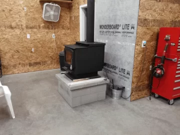

That’s my nc30 and is on the blocks to meet the required 18” height above the slab in this shop area. It is nice to have the stove that high in the shop but not in your home imo.

I dont see any reason not to raise it in the home to other than aesthetics. My regency was up on blocks at the old house.
why stainless? because I have it on hand. I felt the steel layer under the blocks would help evenly disperse any heat throughout the top bricks. it also spreads the weight of the stove out evenly to all the lower bricks, and gives the top bricks and nice surface to sit on.....
it should also add to the R value, again, i'm not thinking of going up the full two blocks, just one. also, I like the looks of it a little higher off the floor.
also,, I'm not 100% committed yet, I'm thinking I might use the thinner flat style cement blocks with the air chambers, lay them flat and then stainless, then my hearth pad, that would only be raised up about 4"
then in the summer, I want to cover the blocks in flat limestone that is the common stone along the river in my back yard. more of a decorative thing, tie in the outside campground into the house.

No harm in using a metal sheet, though most common metals are conductive and do not add to the R value. The metal will help distribute the weight and block any embers from slipping between the gaps between blocks. What is most important is that the hearth design achieve or exceeds the required and tested R value requirement. Concrete has an R value of .095/inch, so not very great. Common brick is 0.80 for 4".
