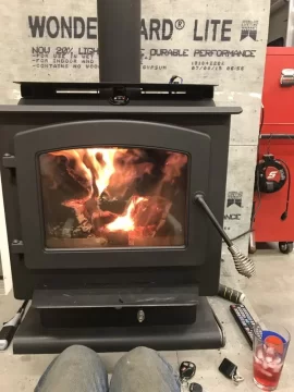

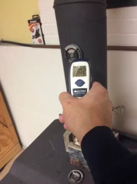

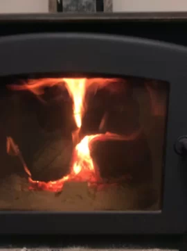

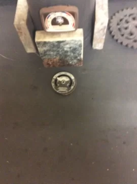

Three hours from a full load of dry Doug for trying to hold 700 stove top temps. This ain’t a cat stove, think pulse and glide.
Cool start with just enough coals to start new load up with a little puffing.
Here is about when I turn things down to where you see the air lever now. I’ll let it ride like this until the stove top is about where I want the stove to cruise at and make my final air adjustment then.
Sorry, stove top pic is blurry. Temp is about 300on upper level.
Sorry, stove top pic is blurry. Temp is about 300on upper level.[/QUOTE
Tried your exact process and it seemed to help. Loaded at about 10:30pm. House was still warm this morning at 6:30am and had large coals. Stove at 200 degrees.
