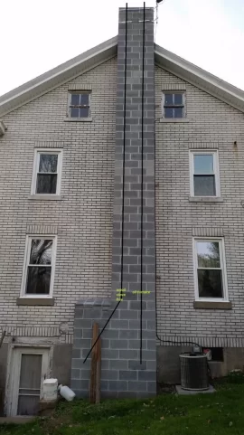

Hello folks,i would like to upgrade to a blaze king ,king model stove and called blaze king and they told me the chimney is way to high to operate there stove,i had this chimney built this year in September with 2 flues in one large block setup.one for oil and one for wood that I made a sketch of on my post here,i have good draft even with the flue being on a 40 deg angle to the straight line,i can blow out a fireplace match and it will suck the smoke up from 2 inches away where the flue comes out of the wall inside so I guess that's plenty of draft ? this is my first time owning a wood stove so I am a green horn on what would pass.i would be very happy if folks here could give me ideas on astove that better then the old Alaskan stove that I have working now,i would like a stove that I can burn for more then 2 hours until I have to add wood like I do now
hope you guys can help me out before it really drops temps here in Penna

A key damper is almost a certainty for this installation. Maybe even two. Are you set on heating from the basement or would a stove on the main floor (with a shorter chimney run) be acceptable? What is the wood stove flue tile size?

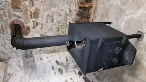

thank you Begreen for the reply, I am setup for heating from the basement only,i opened the cleanout door and it measured 6 inches inside, the builder of the chimney has a 8 inch crock inside feeding the 6 inch in the chimney.my stove has a 6 inch exhaust sure hope there is more folks like yourself looking over my need of information. picture of stove I have now

The problem is that it's too much draft. Most stoves are designed around much shorter flues. A draft that is too high will not allow you to control the fire, leading to overfire conditions. Usually, a flue damper can tame the excess draft to allow a stove to operate normally. I would think that you could find a solution consulting with various manufacturers.
Another solution that is sometimes used is adding air restriction to the stove intake, but that modifies the stove and is not always recommended. But it is done.

This is what I was referring to also. Designers of new stoves that must meet EPA requirements have to design around a typical draft situation. That situation seems to revolve around a flue height of around 15' but can work up to maybe 30' plus or minus.. Part of the design criteria is the minimum allowable air intake. If a new installation draws too hard, then the owner may not be able to turn the air down enough. Designers have to draw the line somewhere.
There are two ways to try to solve an overdraft problem. One is to restrict the flue by way of a key damper. The other is by modifying the air intake (like lindnova above did) and others have done. Many would argue that the technically correct solution is to restrict the air intake, the argument being that the stove designers simply didn't allow for extreme draft. But the most common solution is the flue damper if it can be implemented.
When I spoke with Jeff, I was most concerned that the stack temps would never hold up. First, a 6" chimney with the King model is not anything we will endorse...been down that path many times.

The tall chimney is challenging but not impossible. I would install with a key damper and possibly consider a slight modification of the air intake stop to allow it to close further. You should be able to get decent burn times with a good 3 cu ft stove. It may actually take two key dampers if the draft is huge. In that case one may be left in a permanently closed or partially closed position.
Although the current setup may be for a basement install, I would still consider the option of tapping into the chimney on the first floor, installing a proper and safe wall thimble, and placing the stove on the first floor. In that case an unmodified stove may work out well including the BK.

Thanks jackfre, today I started up my stove and had to keep the door cracked so the wood wouldn't smoke, my question is when I bought the stove used there wasn't, a sign of a door gasket on so I put one on ,did this old of stove have gaskets on it back 30 plus years ago? Should I remove it and try it without ? I am guessing that the strong chimmey draft won,t allow enought air thru the front air knobs even backed out.when I shut the door you can see the flames drop down and it starts to make puffing sounds but smoke doesn't come out the front air knobs, the more I think I can run the stove with the same settings the more I keep scratching my head the air knobs seem like they sit pretty high up from the bottom of the fire box. I am hoping buying a new non cat stove will help me with some of my draft troubles, hope you fellas don't get tired of seeing my post up towards the top everyday you come to this forum I am lost on what my next step should be to make this stove work.
