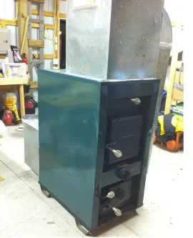

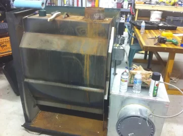

So I am new to the wood burning world, but my girlfriend and I just bought a wood furnace add on to help with heating cost this(and in the future of course) winter. The stove is in very good shape but has a bit of surface rust. on the core. Looks like previous owner had some water coming down his chimney that made its way into the top of the unit.
Before I install it I would like to get it into tip top shape. I was going to wire brush it all down and spray it with "high heat" spray paint. Do you all think this is neccisary? The paint is rated to 1200 deg. F. I am thinking that is good, but am too new to know better, if its not. I just want to make sure that I take care of the unit the best I can. What do you all think? Thanks for any advise and all the good reading so far.

brush & paint it + check under the exhaust pipe for gaps which if paint wont fill, stove mortar/cement will. its gonna stink when it gets hot so the sooner the better.
Not nessary, That looks like its in great shape! You paint that and it will smoke and the smoke will go through the duct work. Spend your extra- time getting firewood!
It sure won't hurt it to spiff it up a bit, but the others are correct, its gonna off gas that paint. Just be aware of that.
That being said, other than cosmetically, you probably aren't really doing much for the stove. You may extend the life by a week or two. ;-)
it'll offgas but will remain black which means the pores of the steel are better sealed against oxidation which is enhanced by the fact that theres a blower involved, geniuses

I think you got it right - clean off the rust with a wire brush and steel wool and put a light coat of paint on most of it. It will smell a bit the first times you burn it, but that is par for the course.
If you paint it open up all the windows and change out your filters afterwards it gets pretty smoky. Wish I would have left mine alone.

If practical and not too much of a pain, you could move furnace outside for the first firing. That'll get rid of most of the stench.
Love this site. I think I will take a little of all your' advise and brush and paint it. It is already out in my garage, so I will just pull it into the driveway and fire it up before I pull it into the house. Hopefully alleviating all the initial smell. I don't plan on spending to much time on it, but would like to spiff it up a bit. Def. want to put more time into getting the wood, which is already going pretty well.
