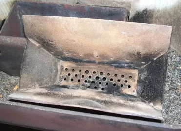

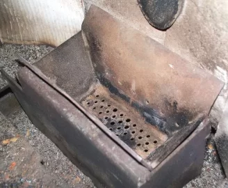

$145.!!! Wow! A small metal pot that would cost $5. if made in China. Before I'd shell out that kind of money I'd seriously consider buying an arc-welder to make my own, ( or maybe rent one). The bottom doesn't have to be a grate, mine is one piece of metal front, bottom, and back with rows of holes for air flow. And it doesn't have to be stainless steel. My sure isn't. I don't know what it looked like when new (1988) but it's very flat finish surface makes no difference to the fire.

Arnash, yeah it would be much cheaper to make one. For me it would be just one more unfinished project. But maybe somebody should start making them and selling them. So if yours is one piece of metal, not a grate, how does the ash fall through to the ash pan?
--Susie[/quote]
The front, bottom, and back are one piece bent into the pot shape, with the two sides welded on at each end, angling inward at the bottom. The bottom has 3 rows of holes for the air to get in and the ash to fall through. The holes I assume were drilled out, which was more costly to make since the hard steel would dull drill bits very quickly. So I discovered when I labored to enlarge 5 holes. But the construction is virtually indestructible. It's so simple and so cheap, I can't believe the outrageous prices being extorted from the public. For prices like those a pot/grate should shine your shoes and wash your car.
