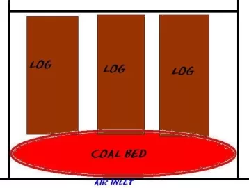

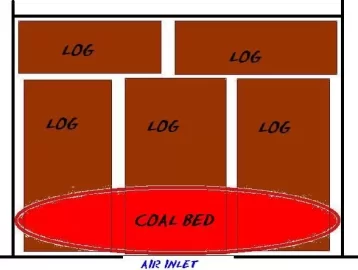

This might be your key:
**** If i rake all my coals to the front of the stove and burn cigar style on a full load i can run longer burn times and less heat .
**** For more heat i spread the coals out a char the bottom of all the wood and the over all burn time is less as the stove burns hotter.
Loading all rounds or large pieces will burn longer and less btu per hour than a lot of smaller pieces.
The hardness of the wood will make a difference. Everything i am burning this year has seasoned 4 years so its not a matter of wet or green wood to get the wood to last longer.
Also HW , the longer you char your wood load the hotter its going to burn per hour , at minimum char ( not under chared ) the load will burn slower.

Ya know, HW, Roo might have hit on something in the last line of his post. In the PM's I sent you with my ideas I also forgot to mention that when I do fill her right up for the night, I usually don't let her blast or char for very long at all, sometims not at all. If there is already a good bed of coals, I fill her up and then close the damper right away, therefore keeping the burn low and slow. Maybe try that and see what happens?
For the benefit of everyone else, my PM's were mostly more questions to HW to get a better idea of what's up. The one main thing I did suggest was to check with the dollar bill test to see if the door is sealing correctly and not letting air in.
I had read about your "cigar" burn technique and have been following that example. Alot of my wood is old oak, no bark, this stuff last a long time, but burns really hot. I don't have much lower BTU wood. Mostly oak & maple. What is "bog" coals? or bog round/split? Is this a type of wood? or a term for stage of burn its in?
I have been continually raking caols forward, some of the wood is so dry though, that they still burn their way back, and not slow as in a cigar fashion. I did get a good burn by front to back in cigar fashion, with a large split of oak on the back east to west. How long should I let the freshly loaded splits "char" before I shut down the air? I think this may be part of my problem, as I think I am letting them char too much and creating a box full or cherry splits. In experinmentation I have let the air open anywheres from 400 to 550 even 600 degrees, then shut down. I think this is also part of my problem. I am going to start shutting air down at 400-450 and see what happens there. I am begining to think I am shutting down way too late thinking I need 500 or so for secondary to kick in. When in reality that is very late and I am creating a fiery inferno before shutting air down.
So my plan tonight is to cigar, char lightly & shut air down immediately after. It doesn't really get below 400, so char & shut down air. I'll see how that goes.
I am still going to buy a second thermometer and slide is back into the blower opening flat on top of the insert, with a flashlight I will be able to read it, and it will be on top as centered as I can get it and still read it. I am thinking it will show cooler than the fron mounted one. I'll try and post results once I get some data if its worth anything. Gotta get another thermometer now ;)

I took a pic of my stove loaded for a long burn , the wood is loaded just for pics , (the stove is cold with no coal)
This is the size wood i am loading if wanting a log burn time , you can burn big wood in the Summit , the smaller the wood the hotter and or less burn time you can/will get.
Also HW , Gage your char off of looks and not thermometer temp , I might have the door cracked for a few minutes and then shut the door with the damper wide open then let it burn for maybe 5 or so minutes then close the damper to 60% open for maybe 10 minutes and then damper down after that.
I ran this stove ( PE summit ) to how much heat i needed for the first year with no thermometer , The only time i look at the thermometer is after the stove has been running for a wile and I'll look to see what its running at out of curiosity. I might look at the thermometer once every other day or so and i still run the stove off of needed heat. I'm a window burner and go off of needed heat and gauge the wood by looks.
I think running a stove by checking the thermometer all the time is a bad habit , but thats just me.
Pictured is a 7" across round of Hedge and some 6" across splits of Oak.
