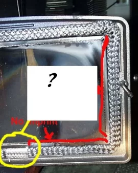

BTW HW , did your Summit come with new upgraded roller ball door latch ?
Is your door handle wood ? is it black ? did it come that way it did you paint it ?
And what is the deal with this part of the door gasket ? < see pic >
I did notice on the lower part to the right of that part of gasket you ask about, the gasket is set back a lil more than the rest. So maybe when time comes to replace gasket, that will be improved. Although entire gasket appears to be making contact now, whioch before it was not on that end of door & bottom.
Yes upgraded design here. Wood handle painted black (came from factory like that). I kinda like the natural wood handle, but the black kinda blends in and doesn't stick out like a sore thumb. Yes it is a roller latch. Which in my opinon I can see wearing out rather quickly. Bit I hope I am wrong. It would have been cool if the roller had a set of bearings on it. Its basically a metal sleeve over the latch peg. What kinda lube you think if/when needed for it? graphite? I guess since it rolls it is easier than none.
I have no clue. Best I can think is its a cover/reinforcement for where the rope's seam is. maybe helps assured air tight, or at least tight at the seam?
Yep , I think the natural wood handle would look funny on an all black stove unless you had like say a gold door and or the gold trim.
My gasket is all one piece and it meets in the lower left corner so sence yours didnt look the same i thought i would ask.
My door handle < metal part > has no roller ball and does show wear but i figured in time i would just bend the stove part of the latch in as you did to adjust the fit .
I called Pacific Energy ( not the dealer ) and asked about the small brown spot in the lower bottom left corner of the glass and thay said it is common to show up in that spot an all the Summits . I didnt really expect a 100% perfectly clean glass but made sure i asked and and all questions the first month of ownership.
When i first got my stove i put the door on right away (still in the garage) wile i was still installing the new hearth and class A ss pipe as to make sure it had time for the door gasket to be seated to the stove before i started burning. It sat new with the door seated for a over a week 1/2 before it was installed.
Ahh, I didn't put my door on til last, and then fired her up. Seems to be doing well, havent even gotten past 550 tonight. and getting same warmth to the house. I think I have a winner. I'll pack her full tomorrow night for the litmus test.

From your other post a few back about the gasket on your door..... You have no lip that edges into the rope on the stove? It just rests flat against the stove face?
Am I understanding that correctly? Just wondering if I understood that correctly. Does it seal well that way? Any benefits/drawbacks to that way over the one with a raised edge to rest against?
That's great. I finally got around to loading the Englander full, leveled'er down at 450 and cruised it through last night. I have also gone back to North/South burning in it like I always burned in my old stove.
Heat on brother.
Seals against the flat face of the stove body. One of the things I noticed looking at the various stoves this summer was that most of the steel stoves do it that way these days. I was kinda leary of it when looking at them because all of the steel stoves used to have the piece welded into the door opening for the "knife edge" seal but really it was there to stiffen the stove body and prevent warpage. And those stoves used steel twice as thick as the new ones!
But I haven't heard of any problems with the other brands sealing that way so we shall see. As long as the stove body doesn't get warped they all should be fine.
Mine has the same gasket as HW with different piece at the bottom middle as seen in the pic
Checked the knife edge of mine out of curiosity. The top is bowed out in the center ever so slightly-1/16. The bottom is bowed in less than the top-1/32. Will almost rip a 5 dollar bill in half trying to slide it out. (No such thing a a dollar bill up here) Maybe it's not supposed to be flat, it's hard to check the door, but the knife edge may be mirroring the doors shape. So far we have 3 stoves bowed out at the top and in at the bottom and 1 stove that is dead flat.
Well, I couldn't stand the suspense until Tuesday, so I drove down to my shop where there are five PE woodstoves on display. All five have knife edges that bow out a bit at the top center, and in a bit at the bottom center. Just eyeballing, but it looked like they described two sides of the same arc, as if the lazer cutter might have been adjusted to cut that arc in the middle of one plate, the convex side to be used at the top of the door and the concave side at the bottom. As evidence that their cutter hasn't simply gone berserk, all ten side edges were perfectly flat.
This got me thinking, which my wife will testify is a dangerous state for me to be in.
I wonder if the bow at the top is there to cause the door to flex just slightly when the door handle engages the catch, to provide a little extra tension on the gasket? I did a quick circuit of the showroom and it does seem to take a little extra force to latch the PE doors than the models we have on display from other manufacturers.
I wonder if PE's new roller-bearing door catch design is an effort to make it easier to overcome this extra tension when closing the door?
The bottom corners of woodstove doors, particularly the one on the catch side (opposite the hinges), are notorious for leaking air: at any rate, that's where we usually see telltale creosote stains on the glass. I wonder if the concave bottom edge, which would present a more aggressive tension surface against the gasket on the outside corners, is a deliberate design intended to help solve the corner leakage problem?

Yout a nutcase, I like that! Mine had very little tension while closing before I adjusted. I did adust a lil at a time untill each area where the bill was loose was more snug.
I woiuld say the bottom just left of center was the worst area. Good thing for the roller latch, cause my door although not having to use both hands, it is still tight now.
But not binding or anything. Definetely solved my runaway blaze problem. I am wondering if anyone else has/had this problem? Other than me and others who have spoken up. The lower latch corner was a creosote factory, but its vleaned up farily well with a hot fire last night. Top latch corner was the worst for me. That is cleaning it seems a lil with each fire. I culdn't get that spot clean with just windex.
