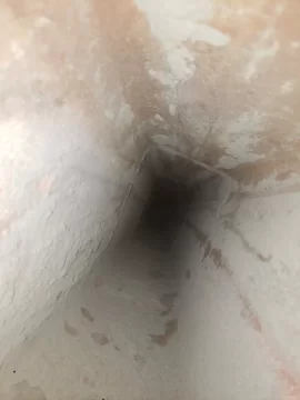

What size is your clay liner?
Thank you for your replies. Is a new crown necessary when they do a knockout?
Not because of the breakout no. But it may need it anyway we don't know
So 8 x 12 clay won't work?
Probably not it's too big. But again we have no clue about condition of the liners or chimney clearances so we really can't give much advice.
Do I have any other options besides a knockout and steel liner? Maybe an oval liner?
Not really an option for 8". You will need oval anyway though so it can be insulated even with breakout
They never got on the roof so I'm not sure how they know i need mine replaced. Weird.
That I can't answer. They may have been able to see damage from the bottom. Or seen lack of clearances. Or just the fact that it isn't sized properly.
