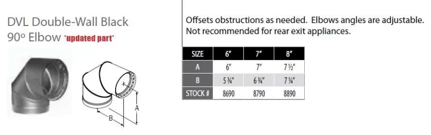

I am going to change all my stove pipe from single to double so I was wondering if someone could give me a measurement of a 90 degree 8 inch elbow double wall. length to the end of the elbow will work then I can figute how long of a piece I need for in between. Thanks
The specs should be available at the manufacturer's website. If memory serves (always a big "if") I was able to spec my stovepipe needs out at the DuraVent site.
Yes, it depends on the brand pipe. Dimensions are in their catalogs. This is DVL:
