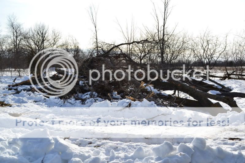

not a very good pic (out the front window) but here is the pile of locust i pushed up last summer, definitely wont go to waste pen as i might even start cutting it today and it will be going in leo's woodstove next season ;-)
loon
will get a better picture later...
[Hearth.com] A common misconception about wood stoves...
maybe not a cord of locust? but a good chunk :-)

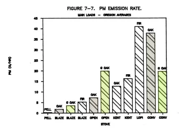

Here ya go (see attached photo). The chart shows about 37 g/hr with seasoned oak, about 19 g/hr burning green oak. That's with the stove not in its more efficient downdraft mode. I'm sure I do much better with the stove at 600-750º with the bypass damper closed.
Now... I'd like to see the study showing my stove emits 60g/hr, so right back at ya. All you're telling me is that some guy who is in the industry says a "typical" airtight produced that much, not a specific stove. There were stoves back then that were even cleaner than mine, like the Kent in the same study the chart was taken from - about 13 g/hr of PM.
I got too much on my plate this evening. I'm hours from being ready to go on a 400 miles road trip. I have to be in Ridgway, PA by 9 AM and the weather is threatening, so I'm gonna let you have the last word here (which I'm sure is imminent). But like I said, I'll burn my beauty until Big Brother (EPA) outlaws it. Here are two reasons why:
[youtube]http://www.youtube.com/user/Battenkiller#p/u/0/k9G_MQ9uWz0[/youtube]
[youtube]http://www.youtube.com/user/Battenkiller#p/u/4/IxdzM2NbWY4[/youtube]
I also have three clips showing my chimney while I was burning a good size load of freshly cut black birch (about 60% MC), and all you see is heat waves against a blue sky. I'm too pressed for time to upload it right now, but I'll get around to it soon. Now, since I don't usually burn freshly cut wood, and since you say I will get my cleanest burns using very dry wood, and since my usual wood is hovering around 12% MC, I imagine I burn so clean I might actually clean the blue right out of the sky. ;-P
  • [Hearth.com] A common misconception about wood stoves...

* I did not say YOUR stove emits 60 Gm/Hr. Read what was said 2/20/11 at 321 PM on this thread and check the reference for emissions of 70's stoves, like yours.
* Homemade charts and videos can be made to show anything to defend almost any position, wrong or other. These you present mean nada.
* Emitting 35 Gm/Hr (your data, your stove, if accurate ?), this is 5 X more than most modern phase II stoves burn today. Simply, it stinks. And, you're content?

BTW that wasn't some homemade chart I came up with, that was taken from a study of several wood burning devices that was done in the 80s by one of the preeminent wood burning technologists in the world, Dr. Jay Shelton. He's forgotten more about solid fuels than all of us here have learned together.
