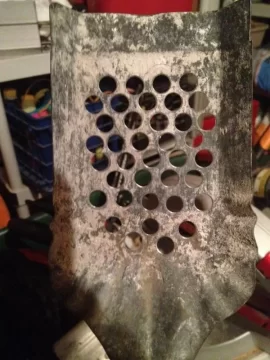

Here is a pic of the one I made.
Hope you don't hold a patent on this, I clearly violated it. Haven't used in stove yet, but worked great spreading rock salt this morning.

Nice, I have actually thought mine would work better with a few more holes.

That's how my granddad did cleaned out his wood stove for years. I do use a shovel with holes in it. I toss the ashes in a steel 5 gallon bucket with lid.
