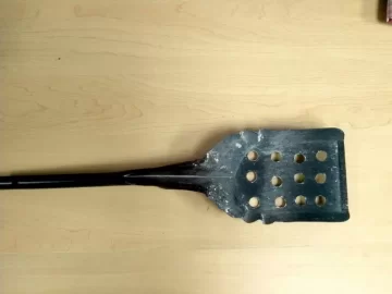

My ash bucket came with a metal scoop with a long handle, I already had a shovel that came with my hearth tools. So I took the scoop that came with the ash bucket and drilled a series of 1/2 inch holes in it and made my own ash sifting shovel. It works pretty good and made good use of what I already had on hand.
I am going to copy what you did. Thanks!

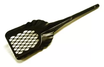

http://www.koalkeeper.com/
Here is a pic of the one I made.
