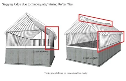

i think you are misunderstanding. the vaulted/catherdral ceilings make the ridge pole the issue. if it sags, the rafters(which are also [part of my roof and ceilings) squat down, pushing the top of the front wall out. hope that makes sense. the bottom of the front wall isnt bowed, its bowed at the top, and it bowes the most in the middle of the room of course, where its furthest from reinforcement. along with the new LVLs, they are lowering the ceiling a few feet with collar ties. while collar ties do not prevent ridge sag, they will stiffen the structure overall in my opinion.
found a pic that shows my predicament. [Hearth.com] A homeowners UGH! moment...

it was a major structual deficiency, as i said, they used only one LVL instead of 2 laminated together. after this it will have 3.

Option B. Pull the wall back in, install some sort of custom / exposed / decorative collar tie to hold the two plates together if it's an open room.
Structural ridges are used when the roof isn't a triangle. The bottom cord of the triangle completes the structural integrity of it. So option B would be collar ties of some sort.
We did it on a rehab that my buddy bought. Had a local steel shop fabricate the equivalent of a giant turn buckle and steel plates to attach it to the top plates of the wall. Got em close w come along and jacks under the ridge, installed turn buckles and fine tuned with them. A painted flat black. Cost effective, worked great, looks cool.
Just FYI, they most certainly do when placed at the right height and location. That's their sole job. Many old houses have no ridge pole at all as if it wasn't needed they didn't waste the lumber on it.
Ties in the upper 1/3 are collar ties, bottom third are rafter ties. Everything I have read says that collar ties are innefective at preventing ridge sag and wall spread.
http://www.nachi.org/collar-rafter-ties.htm
Nevertheless after the triple lvl goes in and the ridge is fully supported we are putting them in. As I said it will help with overall stiffness of the structure and will lower the ceiling some.making it look better.
