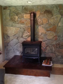

Had mine built over existing one that was built with the ZC. About 13.5 inches. Love the look.

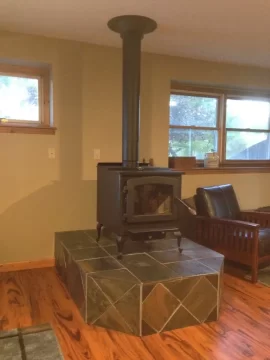

Here's my hearth that I mentioned earlier. It is 14" tall, has the required r-value for my stove, and is covered with leftover slate tile from a nearby area in my house. Stove is NC30 connected to Selkirk Supervent with Selkirk DSP double wall pipe. Haven't used it yet, but looking forward to it.
