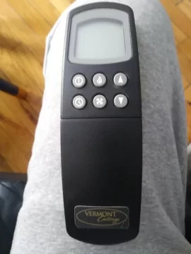

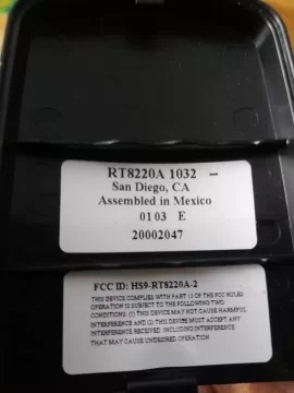

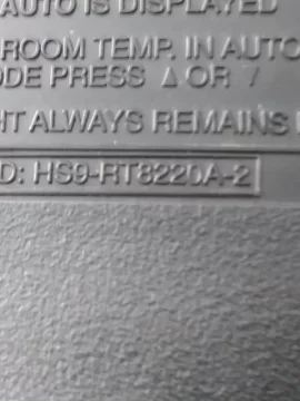

Hi my remote melted…. Do u have a remote I can purchase?
Yes I do.
I'm in canada.
Send me a picture of your remote,it's is in very good condition .
16453047532566934349512683778627.jpg 16453048995318617212612141987621.jpg 16453049402502683608225534994764.jpg
Nel
Feb 5, 2022
9
Mirabel
I’m still trying to fix mine but if I can’t I’ll reach out again, …however I’m in Hamilton, On ( bit of a drive) so we’d have to sort something out. Thanks for replying.
I have both remote and a used ng gas valve with the card .
