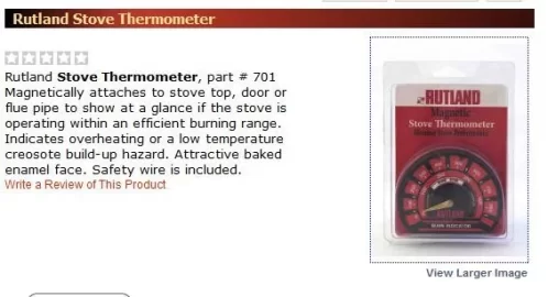

I hear ya, really no problem at all. Just wanted to make sure I hadn't given misleading info or missed something critical. Your point is well taken. We see lots of people running their stove too cool because they are reading the burn ranges using a flue thermometer on the stovetop and not the actual temperature.
The situation is made worse by constantly misleading info like this which comes right from Rutland. The readings from a stove door vs stove top vs flue surface are going to be in very different ranges. If I tried to burn the T6 with stove top temps in their ideal "Burn Range" I would often have a sooty glass and very tiny fires. This stove likes to see 650-700F with every full loading and it is a long way from overfiring. That burn range might be ok for some Hearthstones, but is pretty conservative for the average modern stove.
