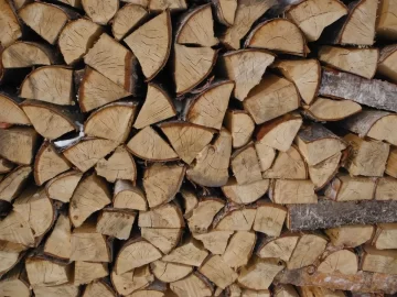

Yes, sublimation .
I cut live trees in the fall, the ends are cracked & drying out before the Spring thaw.
Pic of stuff CSS in Oct, picture taken in March, 6 months later (still below freezing ).
You can see the cracks from drying thru the winter[Hearth.com] A Whole New Game

Are we sure the cracks aren't just from the water in the wood expanding as it freezes? My dad claims that wood freeze dries.

For sure drying laundry outdoors in the winter is a chore! Still, the laundry will dry....to a point. We've always noticed that it takes very little to finish the job that Mother Nature has helped with. So although you don't get all the moisture out, you get most. With wood. we don't want all the moisture out; just below 20% as a general rule.
Wood will definitely dry some in the winter and most do notice that in the cracked ends. However, one must also realize when they see the cracked ends that it means only that some of the end moisture has dried and usually none of the center moisture has came out at all. We stack our logs in the winter and split in the spring. It is very common to see some big cracks but that wood is far from being dry in the inside.

The cracks that appear in the winter time may just be the water freezing and expanding the wood just like water widening a crack in concrete. When I moved in, there was locust that was dried in our garage which is quite a bit warmer and I do not believe would be prone to freezing. It was in there for about 6 years. Checked the moisture. It was about 13% moisture. There are virtually no checks in the wood. A few but not many. Looking at it you would think it was not seasoned but it sure as heck is.
