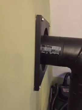

How do you seal the venting? They take it all apart when they clean it.

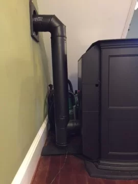

The obvious simple answer is either the vac is leaking or your stove exh system is leaking and being sucked through the stove by the convection fan and spread over the house. Start by starting the stove at night and with the lights off shine a flash light at every joint in the exh system starting at the stove and working your way toward the wall or ceiling where ever the exh pipe goes. The other cause is a leaky filter on your vac. Try turning it on and as you are cleaning shine a light around it looking for soot in the air. Most of the time the joints can be sealed by either high temp tape or high temp silicone smeared over the seams and joints of the exh pipe. Often the installer will not do that on the joint between the stove and rest of the pipe and that would be my first place to look

Thanks - we've talked about your suggestion as well and don't worry, we are looking into that too! We just hadn't turned on the stove yet and it was cleaned at the end of last season, so we figured we would start with the humidifers and then work towards the stove. I'm pretty sure the venting isn't sealed, but they take it all apart to clean it, so if we seal it, how will they clean it? Dumb question, I'm sure.
I'll try to post a pic of it later.

The weird thing is that we aren't really finding much of the dust downstairs... It is all upstairs mostly. The stove blows a lot though, so maybe it is just blowing and being carried up. Or maybe it is the humidifiers since they are all upstairs.
Here are pics of the venting.

Ktenn ash dust is very volatile and with the air circulation it spreads in the entire house. I agree that your vacuum can dust but your biggest problem is the pipe that escapes the very little dust but cons 24/7 continuously. The distribution fan draws this dust comes out of the pipe and spread throughout the house and do not forget that heat rises so the dust rises with heat. Place your finger on the grill or hot air comes out of the stove and you'll find the same dust that you have in the house
My P61 had a small exhaust leak last year. I sealed it up with silicon and also taped the T cap that is located in my fireplace while at it. But any dust I ever got from this stove has never made it upstairs. In fact it's mostly contained within the stove room ( living room) in my case . To which I own two pianos, a black grand piano and a black digital piano both of which show the smallest amount of escaped anything immediately. Just based on my personal experience and I've burned one form of stove or another for a really long time, I don't think this problem is the stove if you only experience it upstairs. Doesn't anyone find it more than coincidental that there are multi humidifiers upstairs and that is where the dust shows up !! LOL
