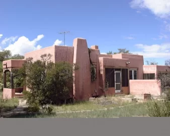

Rhonemas, thanks for your thoughts there. Some details on the house should answer some of your questions. It's adobe-style (flat roof, no overhangs or soffits), built in 1930. The walls are thick - double-wall pentile (like concrete block but same material as brick.) I only see one "vent" in the ceiling, on the north side. The roof joists are 2x12, the ceiling joists are 2x4. This is New Mexico, so moisture buildup is not a problem... Interior finish is lathe and plaster throughout, which provides a very good air seal. I have no draft problems at all (not counting the deteriorating caulking on a few of the windows :-) )
Yes, this house has the old K&T wiring, but only for the lights, so they don't carry much current. The outlets are all wired from the basement. Nevertheless, this is the reason why cellulose is out of the question in my mind. The contractors who inspected it said the same - they would only go with blown fiberglass, but they turned down the job because their boys wouldn't fit up there.
I agree with your ideal installation technique, but I don't think we can do it that way. The beams are roughly on 14-15" centers, the batts are 15.5" wide, so I figured there was enough overlap to give a gap-free installation.

Wow, deja vu. If there was an New Mexico version of my wood framed house that would be it. Same exact "feeling" looking at it.
Sounds like you know more than you're leading about the insulation :) You have it, go with the 15.5" insulation, kraft faced, notched in such a manner it fits tight and covers the top of each ceiling joist, and that's about it. Now... are you in a heating dominated climate or cooling? If heating the paper should be down against the ceiling and no paper on the joists. If cooling the paper should be facing up. I'm still curious how they're going to do it in such a little space, is it going to be installed by a 6 year old!?
Interesting... I hope yours came with less "deferred maintenance" than mine did...
