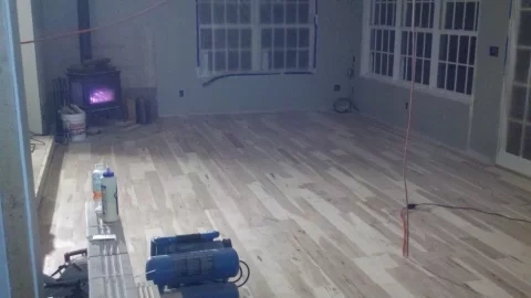

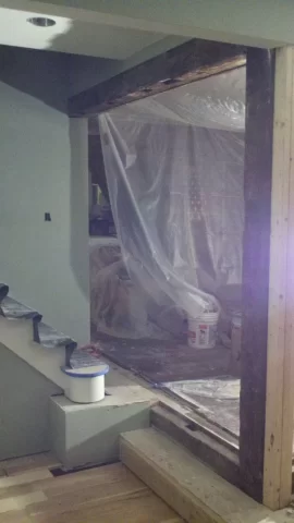

[Hearth.com] About to take the plunge and would appreciate some insight; Jotul, VC or ?
A few quick pictures from the construction time last year. I really need to update with the finished work, at least you can see how the stove is situated. The opening into the old part of the house is about 8' long and turns a corner at the new stairs shown below, with another 5' opening. The TV is in the right corner in the above picture so there is a chair and sectional located close to the stove, facing the TV.
Can anyone weigh in on the possibility that a Cast Iron stove will be overwhelmingly hot at 4-6' distance for seating, compared to steel? I have gotten away from the soapstone but am still looking at the Jotul 600 and some steel stoves. I really feel strongly about the TOP LOAD stoves as the 600 is a side load and may be just at the limit with a corner install, eve if I face it more toward the left wall.
Thanks for all the input, I have taken hard looks at all the stoves you mentioned.

(broken image removed)
Stone sure holds the heat.24 hrs after loading, my stove was still 100 degrees.I know that doesn't heat a house at 100 but it's an example.I'll take the soft heat.
