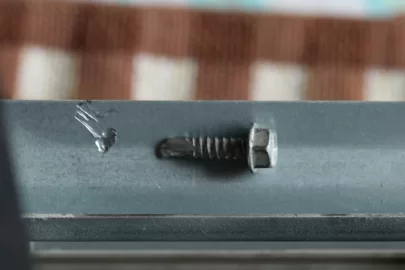

Video with Sound will help. I had Buzz on my Harmon XXV when I got it. I thought it was Combustion Fan too. Had 2 screws impacting Distribution Fan. Easy fix after I got new Fan to replace it. New one still sitting. Got tired of dealer response. They wanted more for service call than fan. So I have spare parts
