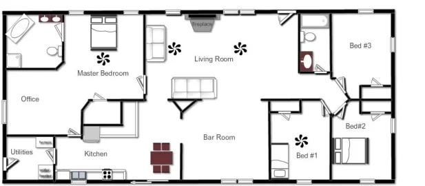

Movemaine thanks for the floorplan site here is a layout of my house its a double-wide mobile home so no basement total square feet is about 1900. I have a living room with couch's that I plan on putting fireplace in, the kitchen and bar room are across from living and I think this stove will heat these quite well. The bedrooms are on either sides of the living and was plan on using fans to distribute heat if needed. The front of stove to front of main couch is about 7 feet so yes I think it will be warm but not unbearable. Tiger as for the TV sitting above stove it will be recessed a bit something around 3 inches so front of TV is more flush with front of the stone around it. So its good to hear that the stone doesn't get to hot. The living room also has two ceiling fans in it to move some of this heat around. As of now my main source of heat is propane and with cost of that reaching $5 gallon last year I'm just trying to find something else. I spend about $2400 on propane if it stays $1.80 gallon and my house is about 62 degrees which is nowhere near warm, this place feels drafty. I hope all this makes sense and like the comments from everyone.

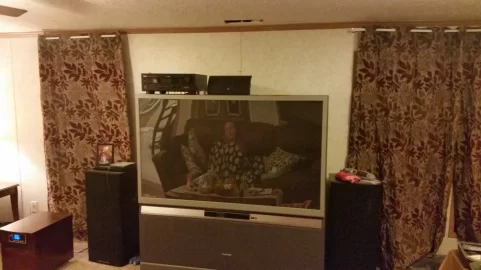

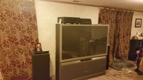

Ok so here is my wall I want to build this fireplace on with it being a mobile home my outside wall is only 7' tall so instead of putting a raised hearth I'm going to flush it to the floor. This will make it seem like the room is a bit bigger I believe instead of taking up the space in front of fireplace. Mainly for walking and to avoid injuries that could be caused with stone edges. Hopefully all this will look ok in the end. I want to be 18" out from back wall and all the way up to ceiling, the width of this will be 80" so almost squareish when you look at it. Need to upgrade this old TV and bring some heat to the house.
